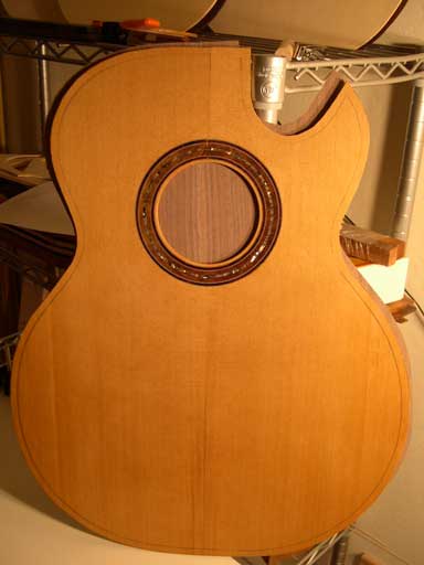

BD (that old devil) sold me a set of plans for an Olson SJ, so I made some molds, got some cedar and walnut from AC Woods and here's the top ready for bracing to start:
Here's the rosette:
That's rosewood on outer ring, walnut burl on the innner and paua in the center. I hate working with cedar though, I dropped a tool and had to steam out the dent
